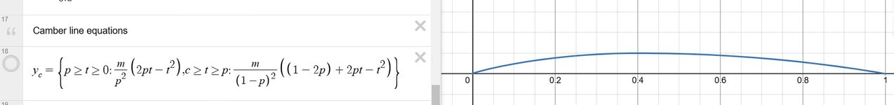

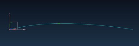

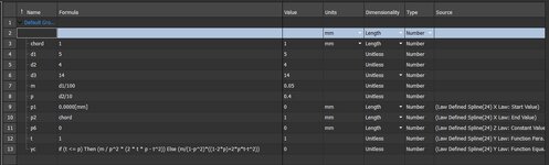

I'm trying to create a law-defined curve. It has "left" and "right" parts
Knowing that there are "if" expressions in NX I tried using it, but when I create a curve using these laws constant function is displayed. Is it not possible to use "if" clauses, or am I doing something wrong?
In pic.1 are my expressions, pic.2 is what I get and how I create a curve, pic.3 is desmos variant of the "yc"
PS
I did this the stuff without using if clauses, but using two of them here creates not 4, but 8 expressions later and it snowballs into a mess of a calculation

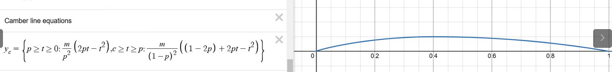

I struggle to do it, can you help with this one? In first I just multiply by p, but idk what to do in the second
Only problem is select ranges:
p>t>0 and c>t1>p
In the camber line equation in pic #3, what do p, t, m, and c represent?

You can use IF statement in Law Defined Spline, but You have wrong expression:
if (t<p)(y1)else(y2)
where:
y1 = m/p^2*(2*t*p-t^2)
y2 = m/(1-p^2)*((1-p^2)+2*p*t-t^2)
(you can type all expresions in one line)

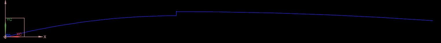

If c= 1 and "t" in Chamber line equation is X value, Your curve is here:
Best regards
