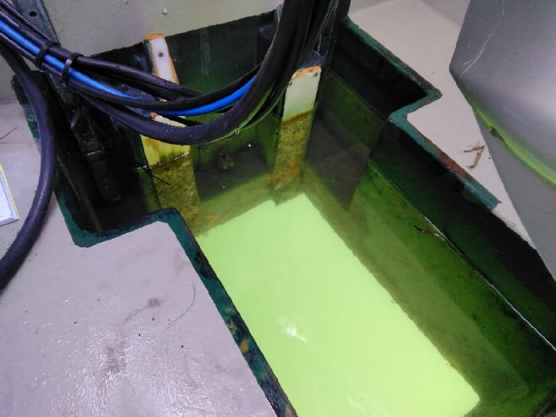

I hope you are the guys to ask......
I have a performance cruising catamaran sail boat. The higher it sits in the water the better its potential. It has outboard motors that slide vertically on rails to lift the leg and propeller up out of the water flow to reduce drag.
As a consequence there is a hole on each side through the hulls that allows for raising and lowering them. When the outboard is up and we are sailing each "well" holds about 25kgs of water. If I can empty the water from the well I will have 25kgs of extra buoyancy on each side, and that's worth having.
I can try to seal it with a cover and pump the water out (least attractive from a design point of view) or I hope I can have the passing water drain it through venturi effect with a clever shaped hinged cover plate. I assume there is a penalty for this in pulling the boat down (negative lift?) or in drag from the plate. Is it equal to the 25kgs or only partially or until it draws air or will drawing air cause the effect to collapse.
Are the speeds required to work out of my range ?
Hole size - round 30cm diameter (that is the max size possible - actual is smaller) smaller the better from the boats point of view
Water column height at rest - 240mm
For good benefits I'd like it to fully drain by 12kn (24kphish)
Dave
P.S. Max boat speed 50kph
