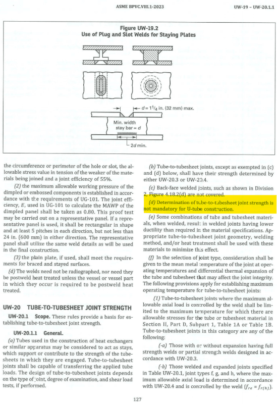

Dear All,
is UW-20 applicable to U-tube heat exchangers?
ASME VIII Div.2 states that "Determination of tube-to-tubesheet joint strength is not mandatory for U-Tube tubesheets" (ref. Para. 4.21.1.1 (d)).
I cannot find any similar statement in ASME VIII Div.1, but it should be the same.
Can anyone give me their opinion?
Cristiana
Same statement does exist in Div 1 2023 ed.
UW-20.1.1(d) "Determination of tube-to-tubesheet joint strength is not mandatory for U-tube construction."
Thanks Maslov, I got it.
I was actually focused on Ed.2021, since I'm dealing with an old project and actually I didn't find the same statement in Ed.2021, so I was trying to understand what is the correct approach.
However thanks a lot for your indication.
Regards
