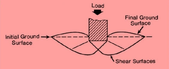

I'm trying understand the risk associated with poor compaction.
Bearing capacity failure as a result of insufficient shear resistance
By reducing the compaction the shear surface will offer less resistance and the footing will rapidly displace down. EDIT If the material is a soft clay or a sand which has a really low relative density or founded at greater depths you can have a punching shear failure.

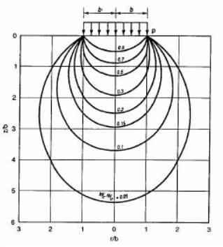

Depth of influence for settlement from a footings width
If your material is not compacted above the expected bearing pressure in the upper zones which have the highest levels of influence over the amount of settlement, increases in load until the construction is completed will cause significant settlement. So when the footing is poured and you attach your first level of foundation walls additional loads will likely cause differential settlement thus potentially causing issues in the foundation walls.

Thank you for the responses and figures GeoEnvGuy. Very helpful. Would you mind sharing the source of that depth of influence for settlement figure? If a textbook or a good reference book, I'd like to get it.
So as to my original question, trying to understand the risk associated with poorly compacted soil, sounds like it is unplanned settlement. Correct?
So my risk assessment on a structure that didn't get compaction testing on the soil at the bottom of footings would be what would happen to it if some or all of the soil under the footings settles differentially. Is that right?
OG here for comment. Whether by this diagram of stress or not, here is the rule I use as recommended by B.K. Hough in his text. "Basic Soil Engineering". When the added pressure under the footing due to its load is below 10 percent of the existing soil pressure, that's sufficient depth to be computing the influence of the footing below that point. Maybe call it depth of influence. So, if the footling is deep, the depth effect of it is less than if the footing was shallow. So that pressure diagram has to be used along with the natural soil pressure from earth above the footing, etc.

The image of influence for settlement is a bousinesq stress plot from google, it is a common figure in many textbooks. Also the plot changes whether you have a circular square or strip footing. You would also need to consider the depth of the footing as described by OG above.
You are also interested in a good reference textbook there are many free publications from department of transportations in the US. In Canada the primary reference is the Canadian foundation engineering manual. In most universities I believe they are typically using current textbooks authored by Dr. Braja Das.

BigH, "2x width for square footings or 4 x width for strip footings. Footing width of 450 mm means that the zone of influence is between 900 to 1800 mm. One has now confirmed the upper 150 to 200 mm; one has not confirmed the zone below this testing depth" I had the same thought looking at that zone of influence diagram.
