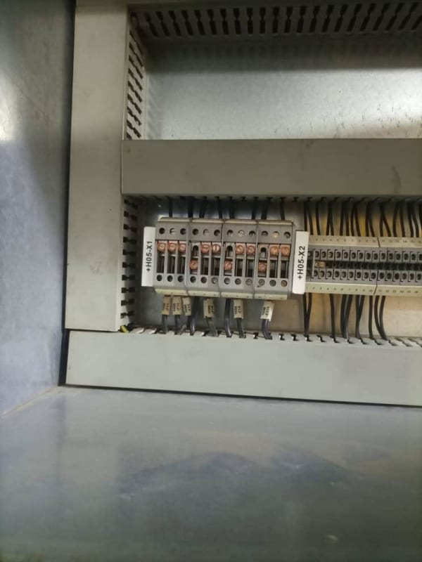

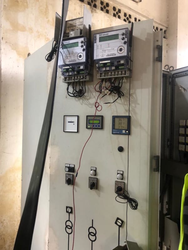

Not yet. I am doing long distance troubleshooting. Client is in Africa and I am in India. Will update when I get more info.
Initially, the utility local guys said everything is fine with their metering. I forced them to re-check and to their credit, they sent an actual metering guy from their HQ to check this time around. Client was pissed off.
You can see the removed CT wires and their troubleshooting external red & black leads in the pic below.

Turns out that during generator outage, the utility guys checked their CT's with secondary injection and then forgot to re-tighten all 3 CT leads. [mad]
Muthu
Your client was lucky as it was an easy fix. Several times loose CT leads have caused collateral damage at my company - burnt terminal blocks and melted wire.
