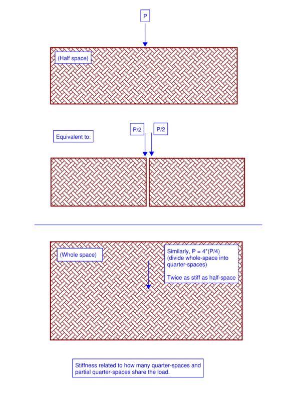

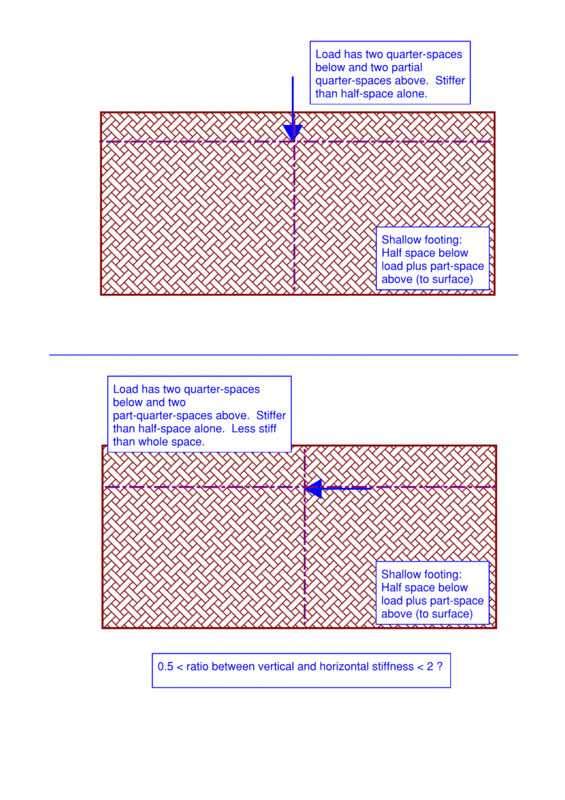

A load applied to an elastic half-space would have a certain stiffness, call it X.
A load applied at a small distance into the half-space, acting away from the boundary, would have stiffness >X. This corresponds to the vertical load case.
A load applied within a whole-space has stiffness 2X.
A load applied within a half-space, parallel to the boundary, has stiffness <2X. This corresponds to the horizontal load case.
How does the difference get to a factor of 2.5? What have I missed?

Steve, I don't think I'm following you there.
I knew it needed sketches when I was typing it, but was typing on a phone. Hopefully the images below clarify why I expect a maximum of two as the ratio between vertical & horizontal stiffness in an elastic analysis. But researchers seem to go beyond that, so I'm wondering what the trick is.
