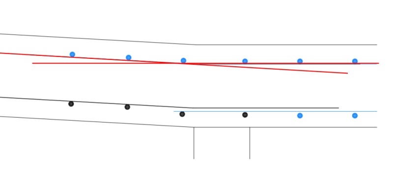

Vertical Crank in Suspended Slab
I haven't heard of a reference, but perhaps when the splitting force across the joint is less than the tensile strength of concrete is one limit?
Similar to the procedure for checking the connection between a flight of stairs and landing.

The standards manual of one of my former employers used to say that you were okay up to 4% difference in slopes. So close...
Not that there was any science to it as far as I know.
One of my old concrete consulting employers used 3% and for more than that, bars were anchored on each side of the 'crank' to prevent rebar tension uplift from popping out the concrete.
My intuition is that it will be fine, but the structure has 100 year design life.
So I guess since there is no solid literature to back it I will have to continue it through
at the angle to splice with the respective bottom and top bars.
Thank you all for your input.
1) Franky, I struggle to find any decent theoretical justification for bending bars around reentrant corners at any angle. That, particularly when you consider that the radius of the bar bends means that you probably have less cover at the knuckle than you do in general.
2) People are fond of pointing to the various "percentage rules" as having been tried and true over many projects and many years. My suspicion is that a lot of these situations are greatly helped by the fact that, often, the sloping slabs will have in plane restraint coming from somewhere which will tend to change the situation substantially.
