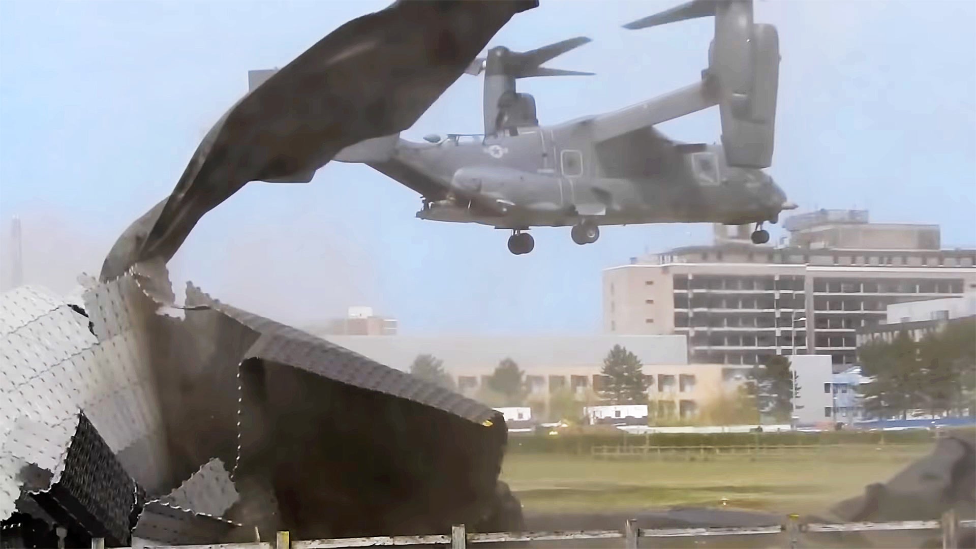

A quick google suggests that Joby S4 (~9.4 lb/ft^2) is a bit more than the disc loading of a CH-47 (8.8 lb /FT^2).
In practical terms a CH47 downwash isn't remotely the same as an R44.
CH-47 downwash
Its still a long way from a V-22 at 26.68 lb/ft^2
Really its just yet another reason why eVTOL dead in the water for all but the smallest niche.
