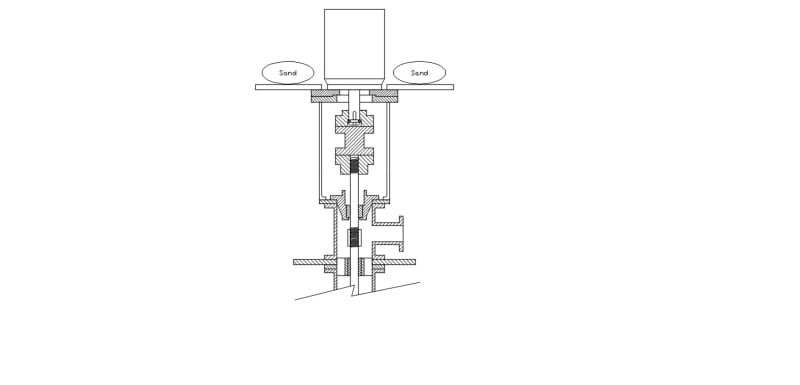

I finally got the vendor to acknowledge we have a problem. They are designing a spring plate to sit between the pump and motor to lower the natural frequency. Does this make sense to you guys?
I have never heard of a spring plate and do not know how is lowers the natural frequency. You can simulate the effect by adding mass. Bolt plates to the sides of the motor flange using the motor attachment bolts. Stack sand bags on the plates. This will drop the natural frequency and you can prove that it will work.

I have seen the spring plates installed on three vertical pumps. The first design require modification leading to removal and machining. The spring plates did not perform well, so they were all removed and the motor support and pump column were stiffened as the final fix. Be very careful about use of spring plates if the motor thrust bearing also support the pump rotor! If all modifications are the responsibility of the OEM, then stand back and watch, but if down-time is an issue, then get involved!
I did detune LNG tank pump (only one of two with high vibration). The test/demonstration weight was diver's belt lead weights strapped about motor, and the final weights were bolted to supports attached near the motor base. The vibration mode had greater motion at the motor base rather than top of motor.

705 cpm is quite a low frequency for structural vibration mode of the motor on support pedestal, but perhaps a vibration mode for the entire pump column. The LNG pump I worked on had about a 40-ft long pump column, but the natural frequency near 3600 cpm (60 Hz) was dominated by motor motion. The detuning weight was about 50 lbs. (from faint memory). I would not even consider this for your machine without more information!

Regarding the spring plate: has the vendor convinced you that the motor vibration mode is dominant?
