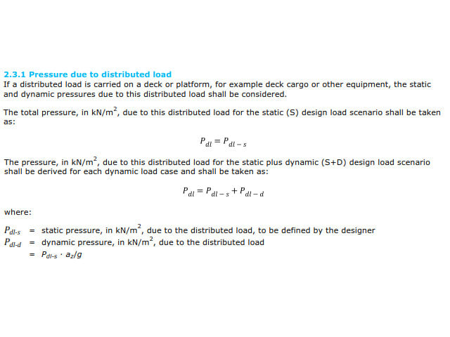

Does anyone know if a stated cargo deck strength of (10Te/m2 in this case) stated on vessel brochures is inclusive of sea motion forces ? ie Can I put a dead load of 10Te/m2 on the back deck or can I only put on something like 6Te/m2 by the time I account for sea motion forces.
