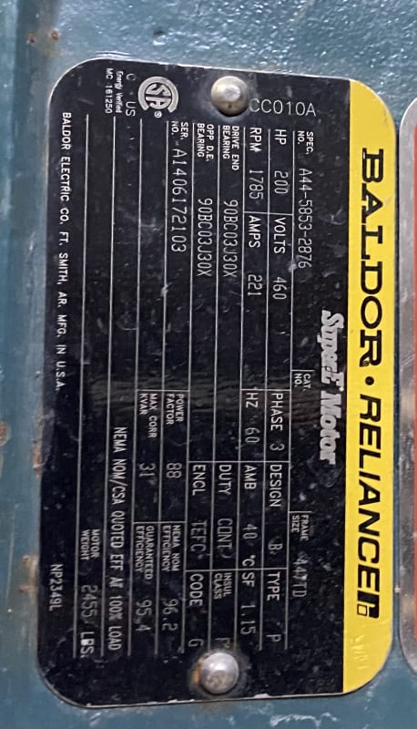

Pete,
Here is the nameplate for the motor.
My first example was worked using roughly the info on the nameplate. The train of thought is that if at a full load of 200 HP the efficiency is rated for 95.4%, then an inequality can be formed to determine the losses (assuming they are all heat) and converting it to the tonnage required to cool the motor.
My thoughts are that the resulting tonnage of 2.125 Tons of heat output seems far too low, leading me to believe the VFD running the motor may be playing a factor to increase the losses of the motor.
In addition, the VFD runs the motor between 740 RPM and 1450 RPM. I am unsure how to determine the efficiency of the motor with the additional variables of the VFD and lowered RPM.
Thank you everyone for all the helpful replies and food for thought.
1785 RPM is 15 RPM slip. That is a slip frequency of 0.5 Hz. The rotor will see 0.5 Hz at full torque across the speed range.
So rotor losses will not change.
Torque is related to current and so at rated current the stator losses will be the same.
That is the losses expressed as Watts or tons of melting ice. The losses expressed as a percentage, roughly inversely related to speed.
