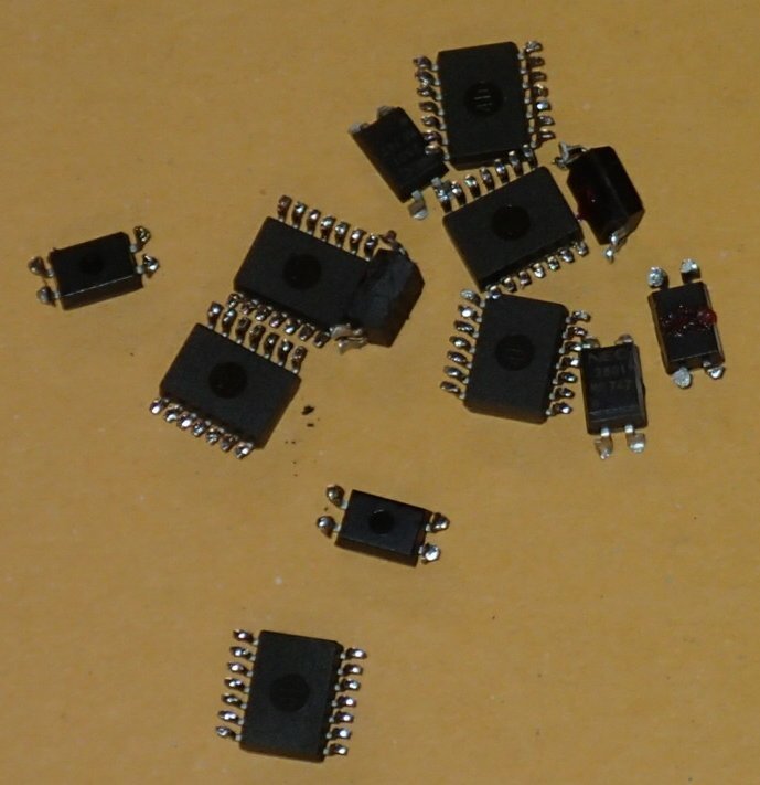

So I'm ditzing with a VFD that has an issue. We'd just replace it if they were available in the USA and a measly 1kW unit wasn't way over $1k.
This VFD is for the Z-axis of a machine tool.
As soon as the drive is commanded to output a drive signal it faults on over current? I went thru the usual "is the brake stuck on?" stuff. Nope.
I finally swapped the drive with the Y-axis and, sure enough, the problem jumped to the Y-axis -> it's the VFD.
I tore it apart looking for the current sensing and on the third of 4 boards there were two large current coils. Hunting down the part nums showed they were actually Hall effect sensors. That explained the four terminals!
While working out what everything was I discovered (6) PC928 ICs. I assumed they were opto-isolators but on pulling up the data sheet it turns out they're opto gate drivers. They also monitor the actual current thru their associated IGBTs via the change in VCE. They put out an over-current signal at some threshold. Unfortunately, complicating this is the need to isolate the overcurrent signal from the PC928 back to the in-charge CPU. Opto couplers have crummy life expectancies since the IREDs age quickly.

Whada you think has failed, a PC928, or one of their over-current signal optos, or maybe one of the Hall effect current sensors? Anyone heard of "the typical" over current problem when it's in the VFD?

I replaced all the PC928s and their related over-current signaling optos and it fixed the problem. Directly after the replacements I reached a screwdriver into the unit and shorted the output of one of the over-current optos as would occur during a perceived severe overload and the drive faulted to the exact same fault we'd been seeing, so this kinda confirms that it was this aspect of the drive and not the current-coil measurements, which I suspect are read much slower for averages and to monitor for motor overload protection etc.
So, no not scrapped but repaired!

The re-placed:

Very good job Keith! Did you figure out WHICH ONE of those chips was the weak one? :)
Since you enjoy doing this, keep in mind that as dc bus caps age they allow more and more ripple to pass, and this can also be cause of worsening cases of seemingly untrue overcurrent detection faults.
Hi Mike! Thanks. Ah yes, al caps are always the most suspect and first thing to look at but in this case there were surprisingly few. Not a single one on the drive board. There were a few on the powersupply board but I didn't go there much this time around.
I did not figure out which one was at fault because they were all ganged and to run the drive the four boards all had to be stacked to operate. The power traveled between boards via screws which rigidly positioned them. This GREATLY restricted access to the pins of interest in the assembled hot stack. I'd have had to solder wirewrap wires to all the SMD pins of interest which would've run the time past all reason instead of just past reason as was the case..
