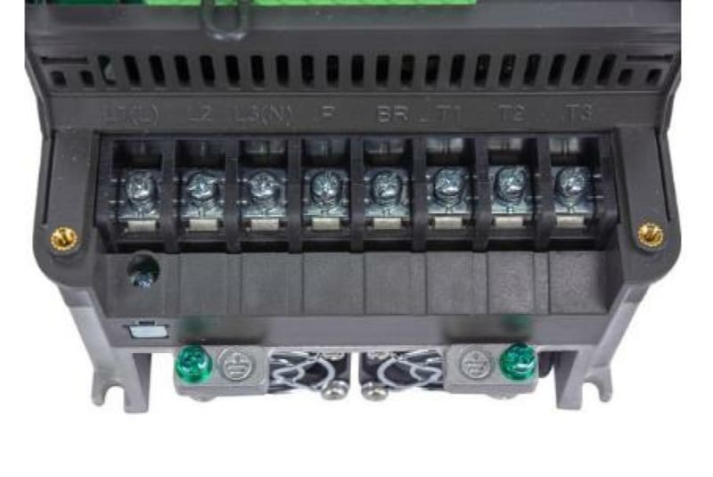

Here's a typical VFD. Note a lot of them them have 2 ground screws. One would go only to the motor. The other gets connected to the local PE ground that's grounding everything. That means all the HF that's trying to get back to the power stage of the VFD has made it back. For it to leave into the facility PE network it would have to cross the VFD body and leave via the star ground.
If your VFD fails to include a second ground then you're stuck with using a single connection but by all means continue with the described topology. Bring the motor ground and the network grounds there separately.
While the ladder might seem like a good HF ground path it will be radiating noise everywhere and coupling the noise into all the cables on the ladder. That's not a step in the right direction.
