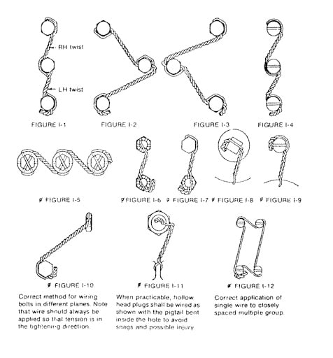

Think about safety wiring the fasteners
Tie wire keeps the fastener from falling out once it's loose. It's a poor choice to prevent loosening.

TugboatEng - disagree
In the event the material clamped by the bolt deforms it's possible for the entire preload is lost - lockwire is to keep the now-loose fastener from escaping and either getting somewhere it should not be or to keep the fastener in the hole where some amount of shear load can be carried. Lockwire cannot produce additional spring load to compensate for the loss of preload due to embedment, differential thermal expansion, or wear. Unlike locking compound it will retain the head of the fastener if the fastener fails due to fatigue or overload - possibly covering up a dire situation from casual view.
The primary function that lockwire serves is to remind the installer to check the fastener is actually tight - it's tough to install when the bolt or nut is loose without noticing that fact.
