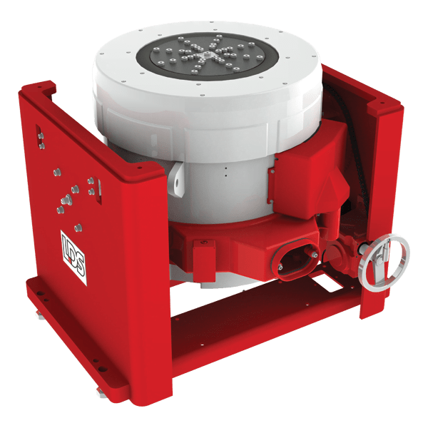

I am currently doing a college project in which I have to find the natural frequency of a disc of about 250mm in diameter ( axis symmetric disc). For doing this I mounted this disc to an electrodynamic shaker and had done a frequency sweep from 5hz to 500hz.
I have attached 4 strain gauges to the component and 2 accelerometers to the fixture. Around 250 hz I am getting a sudden rise in strain data reading ( A peak) also there is a loud sound for 2 seconds.

Your experimental setup may be wrong. Where is the shaker attached to the disc? How is the shaker supported? Is this your first time doing an experimental modal analysis? Can you plot the mode shapes for FEA and test?

On top of this shaker the fixture is attached onto which disc is attached
the heavily meshed part is the disc , bottom fixture and vertical shaft fused as one component , over which disc is put and on top a plate over which the bolt is attached. There is quite a bit clearance in bottom part of disc . I have even put one bolt under the disc to raise the height but same results were obtained .
So not wanting to say I told you so but you have suppressed all modes that have zero displacement at the centre, ie a large number of modes. You cannot excite a modeshape where it is has zero displacement (nodal in the jargon).
