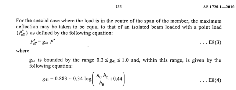

When checking a timber floor for vibrations, 1170.0 Table C.1 suggests 1kN point load at midspan with deflection less than 1 to 2mm.
For a timber floor, with say 20mm strandfloor on 240x45 @ 400 spanning 4m, how much load sharing would be reasonable? It is there a rule of thumb for this? Also, it is reasonable to take the 2mm deflection limit (not the 1mm)?

The condition in question is a residential floor in a single family unit. The member spans from perimeter wall to wall (4.3m) and has a 600mm that supports the first floor wall and roof above. The (dead load) point load at the end of cantilever, takes out the a lot of deflection, but is not considered in a vibration case, it is suggested to use just ψsQ.
Distributing the 1 kN over 3 members gives a 1.3mm midspan deflection. Again this is not considering any G, notably at the cantilever, which would act like a precamber. Can that G load (exterior wall and roof above) be accounted for - it is permanent dead load?

In regard to load sharing, 1720.1 and 3603 address load sharing for a centrated loads in a grid system.
1720.1
G41
3603
k9
My numbers showing both g41 and k9 are about 60%.
