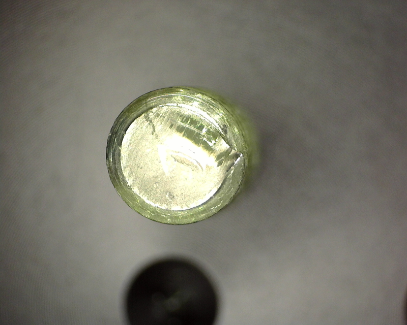

Background:
There was a random vibration testing and the DUT was over-tested with two times higher Grms than the test profile. Screws are broken.... There were some static tests conducted before the random vibration.
Some comments that there might be some fatigue to cause the screws break. However, the screws break at the first Random vibration and it happened about 20second. All the previous tests were static test...
By looking at the photos below, would there be any chance of fatigue failure? Or the screw was broken due to high shear force?
[URL unfurl="true"]https://res.cloudinary.com/engineering-com/image/upload/v1716027720/tips/A012_-_20240517_120826_dgmwpw.bmp[/url]
Hi Sarcee
The fixing does have a dull and shiny area which would be similar to a fatigue failure but I can’t be 100%.
It might help if we knew what the fixing was apart of and how the comiponent is loaded?
There is a lot of reflection from the light to really be able to see the failed surface.
