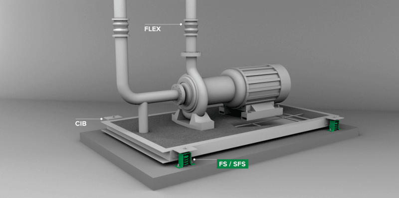

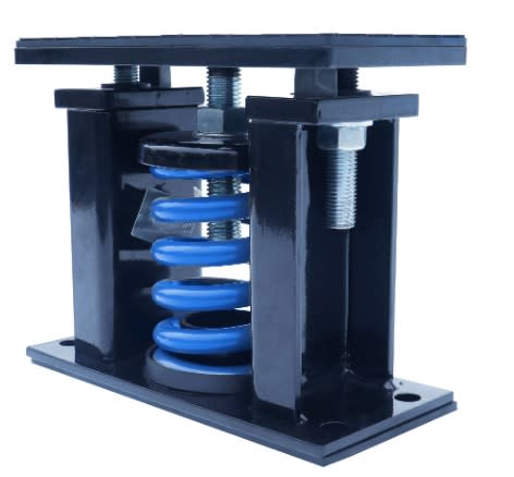

USE THESE BELOW AND DONT WORRY TOO MUCH [pipe]
