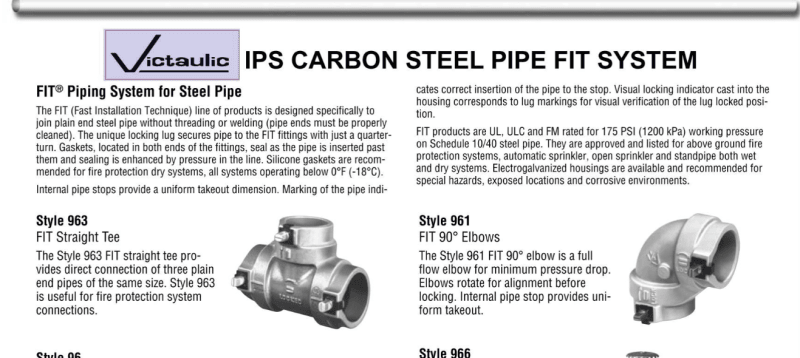

It's not easy to find data on this, but appears to use a Fast Installation Technique (FIT) whereby the outer screw is turned 1/4 turn which seems to move a locking screw onto the pipe and secure using friction between the pipe and the fitting. Lots to go wrong there....
The seal is also a one way chevron type seal which is subject to damage / tearing etc if the pipe is removed. So not like an O ring at all.
It also needs the pipe to be inserted a certain minimum length which is not always done in practice.
This little snippet is as good as I can find as Victaulic seem to have washed their hands of it on their website....

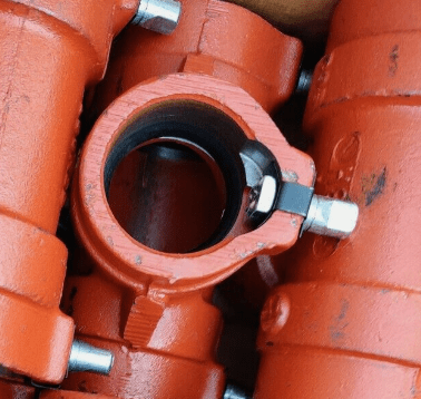

You can just make the seal out in this picture.
What are the general thoughts on quick installation fittings. - IMHO, they are all higher risk than welding, screwing or the "normal" victaulic joints. The risk is damage to the seal from burrs, sharp edges etc, incomplete insertion, lack of grip from the "locking" device over time, inability to remove and reconnect without damage to the seal, no QA possible other than pressure test and checking complete insertion has taken place. Installers tend to love them as they reduce time and hence costs by a large factor. Issues only become apparent many years after the original contractors have vanished / warranties expired.
