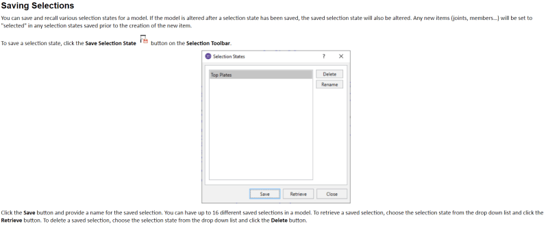

You can also save the selection and give it a label. Then you can recall that view later on by choosing the label from the list of saved selections:
This feature would be better if it could auto-generate elevation views for elements on each grid line, or plan views for planes where diaphragms are defined. Also don't like that it is limited to 16 saved views. I might send them an email with these suggestions for improvement, but I suspect they feel certain features like that compete with their RISAFloor module and would be in danger of making RISA3D too useful as a standalone module.
