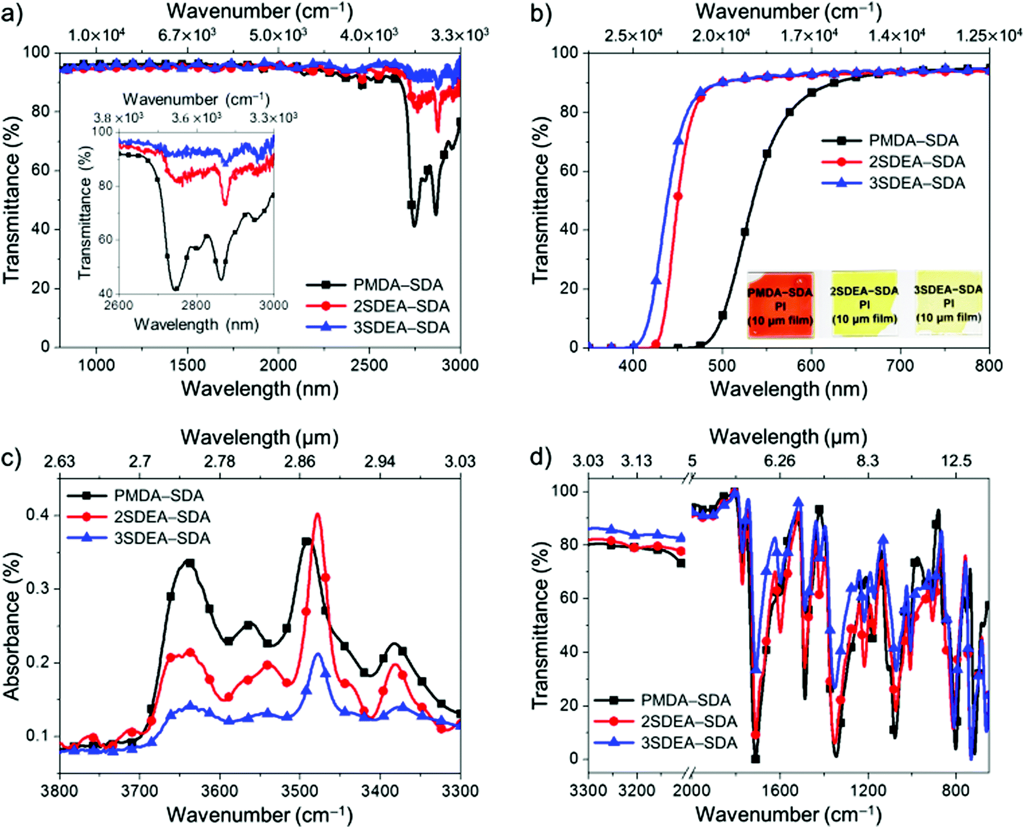

I acquired the transmission characteristics from the manufacturer. Unfortunately the IR spectrum for TOPAS is also very limited in the 7-14 micron range - see below.
Your transmission % will drop significantly with thickness as well. The materials in the graphs IRstuff provided are only 10um thick films. What thicknesses are you considering?

In order to be transparent the spacing of the atoms needs to be right. It seems to me that in the jumble of molecules in polymers that it is less likely than in more regular materials to have a uniform transparency across a range. Ref and
Which is why sapphire and germanium are popular IR window materials and I expect that polymers are not.
