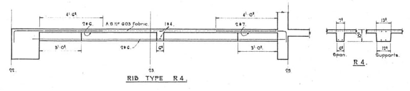

The existing ones I come across in Australia appear to have been designed based on the concrete shear capacity of the ribs. The ribs often step out horizontally as you approach the supports for this reason.
When I’ve designed them I add shear links if the shear loads are getting high, even though as you say you can treat them as a slab and omit the shear steel. In the event of a shear failure a potential plaintiff could likely find someone like your old professor who’d be willing to swear that it’s malpractice to have omitted the ligs.

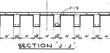

Here are some real life Australian examples of suspended ribbed slabs with no shear steel.
