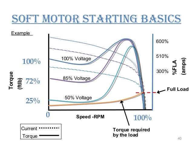

Use a soft starter.
Use a VFD.

If the voltage drop is the primary concern, the soft starter should solve that. But acceleration time and starting torque will decrease. If trying to start motor with a loaded crusher, the real concern may be having adequate torque to accelerate the crusher without stalling.
