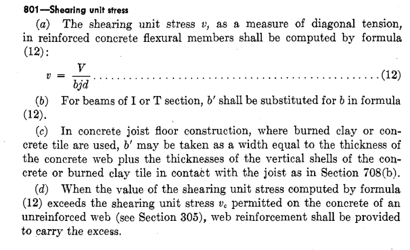

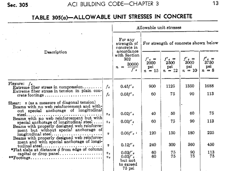

I have a copy of the 1947 code and the allowable shear stress is as follows:
And here is a part copy of Section 8 re shear for beams/joists:
I am not sure if this of assistance.

Wow! That is exactly what I was looking for, and gives the complete picture of allowable stress and how to calculate it. Thanks for going the extra mile to find it and post it here. Much indebted to you. Interestingly, the allowable 1951 ACI shear stress of 60 psi for 3000 psi concrete was much less than the 1965 National Building Code of Canada's (NBC) 90 psi. The current NBC says for permissible factored shear:
vc = 0.19 phi root f'c (metric)
which translates into unfactored imperial as
0.19 x 0.65 x root (3000/145) x 145 / 1.35 = 60 psi
where 1.35 is the usual average load factor of the 1.25 and 1.5 dead and live load factors respectively. Current ACI has different factors but I believe the end result is similar.
I note that the 1951 ACI did not have the 10% increase for joists that later codes have, including the current NBC.
So current Code seems to be essentially the same as 1951 ACI, except for the 10% increase for joist ribs.

Just to be perfectly clear, the tabulated info above is from 1947 NOT 1951.
ACI 318-47 indicates two values for allowable shear, namely 60 psi without special anchorage of the longitudinal steel and 90 psi with special anchorage.

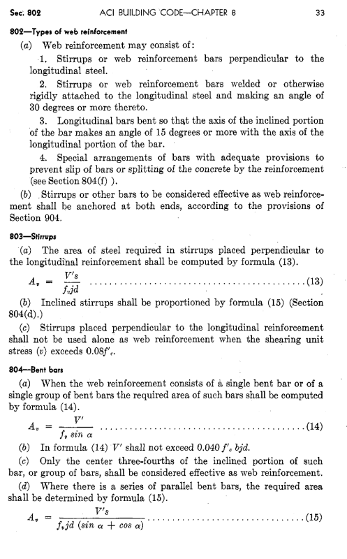

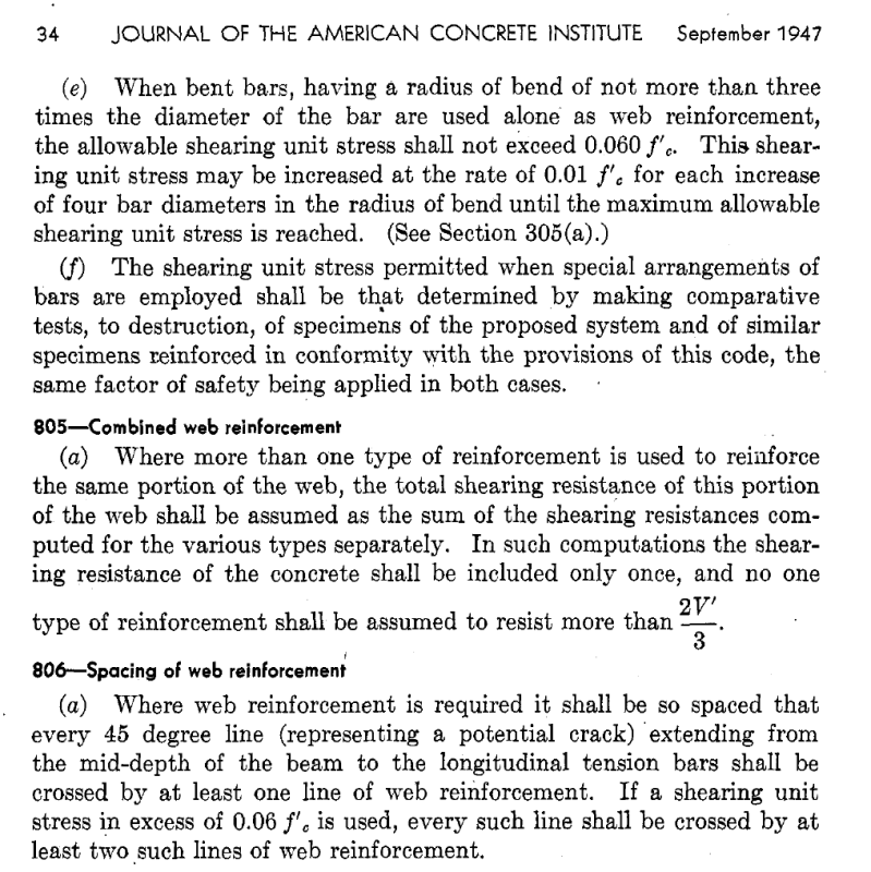

BARetired - thanks for pointing out the increased allowable shear if longitudinal bars have special anchorage. I don't see that wording in my 1963 edition of ACI. Do you know what they mean by "special anchorage"?
From ACI-318-47, Section 802(a)(4)(page 33 below), references to Section 804(f), on page 34, as follows:
Page 33:
Page 34:
To Ingenuity - ok, thanks. It seems that by special anchorage of longitudinal steel, they mean what we used to call bent bars, where the bottom steel bends up to become top steel.
