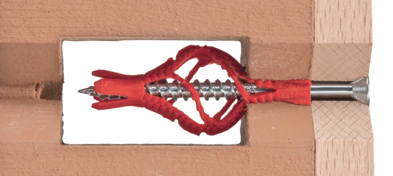

I'm faced with mounting a bunch of 300 pound enclosures on cinder-block walls. I'm looking at a bunch of so called "fasteners" but have little confidence in what I'm seeing as a lot of it is probably marketing BS.
Does anyone have something they actually trust to stick enclosures and Unistrut to Cinder Block walls (or concrete masonry units)?

I'm thinking maybe Tapcons, the blue things. I wonder if I need the larger ones with the square ends or if the more common pointed screws would be fine.
Keith Cress
kcress -
Tapcon screws work well
The right size hole made with the right bit and hammer drill are essential.
Anything longer than the thickness into the void is a waste.
What is the installation? If you have large temperature variations or vibration from plant equipment, Tapcons by themselves may loosen. In a lot of the plants we work in, we hang vertical runs of strut to the wall with Tapcons, but run them all the way to the floor to support the weight better, then hang the enclosures off the strut.
Most sites, like wastewater or power plants, we use 1/4" Tapcons every foot. Be careful not to overtorque, the install tool is worth the money if you haven't used them before. On old cinder block we also add a dab of anchor epoxy.

Did you consider Red Head sleeve anchors, or similar?
More work than Tapcon but, done properly, will give some serious holding power.

The CMU wall may not likely take serious holding power. [pipe]
Most fastener systems are good in shear. How far from the wall is your center of gravity? You only need a little resistance to pull out. These have very good pull out numbers.
Disclaimer: My experience is with adhesive mount fasteners in metal. However, there are some tricks here. One issue is leveling the enclosure to the surface so you aren't using all of your pull out strength to distort the enclosure. I usually put a nut on the stud prior to installing the enclosure and then run the back nuts until they touch the back of the enclosure flange before tightening the mounting nuts.
Expansion type studs require tension to remain in place. Install a spacer and then nut first to maintain tension on the anchor, then install a second nut for leveling before placing the enclosure and final nut. Install the anchor slightly proud so the expansion nut isn't also pulling on the anchor

Thanks all. Looking at your responses I went ahead with Tapcons (my first). The enclosures are 3ft tall by 2 feet wide and I estimate them to be about 300#. I couldn't get my beliefs behind the 1/4" Tapcon and while weighing the 3/8" ones in my hand I stumbled across 5/16" ones! I went with those. I have a very nice hammer drill I'll drill the holes with.
I have to mount the enclosures to short Unistrut then mount the Unistrut to the walls because the customer isn't dead-certain where exactly to put the control panels and fears having to move them again. Mounting them via the Unistut avoids the nightmare of having to remove loaded, wired panels before a move can be made.

Interesting point on keeping tension to keep the anchor locked in the wall. I'm noting both the pull out and shear are about triple the same size of four-way expansion anchors.
5/16"
650PO 820SH
verses
2,250PO 2,505Shear.
Oh, and that's the bolt in the considerably larger anchor. That means drilling MUCH bigger holes in the masonry. NOW I understand why Tapcon keeps touting "installs faster". The masonry hole size might be all the time difference. A 5/16" anchor requires a 1/2" hole.
