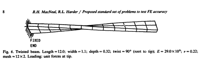

Well...
There is a standard patch test which checks the stability of finite elements shells under extremely warped conditions. Its the McNeal's twisted beam problem as shown below:

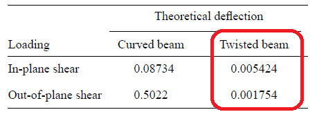

(Note: The deflections are measured in the direction of the loading at the tip.)
For the mesh density that this patch test is checked against(12x2), each element along the length of the beam is twisted by 7.5deg and the peak warpage is in excess of 10deg which occurs at the mid-span of the beam. There is a special variation to this patch test mentioned in R.D Cook's text of FEA (Cook, et.al. "Concepts and Applications of Finite Element Analysis" 4th edition) where if the thickness is reduced by an order of magnitude (say 100) the test then check membrane locking of shells in addition to the twist and warpage. The text also contains the theoretical results for this variation of the problem.
I have no idea what kind of a structure you're modeling, how severe is the warpage and how coarse your mesh size is going to be, but as other posters have mentioned if you stick to the limits in your solver then you should be okay. But before you take a stab at your problem I would suggest you to model these patch tests on the elements that you are supposed to use and see for yourself where they stand against benchmark results.
