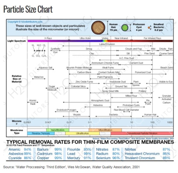

Strainers are generally capable of removing 100 micron particles and larger. A strainer will not remove fine silt that may be less than 50 microns. A HydroCyclone would probably not work either.
To recommend a product, one would need to know the flow capacity and pressure requirements.

Your options include
(1) A multi-media pressure filter system. Pressure filtration systems are designed for industrial water treatment where the removal of suspended solids such as particulates, iron, manganese, free oils, mill scale, and other precipitates in ground or surface water is require. You are looking at 2 - 3' diameter filters;
Filter
(2) A membrane microfilter or ultrafilter.
Ultrafilter
The pressure filter will probably be more economical.
