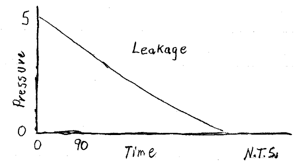

Start the test exactly the same way, but continue monitoring pressure for a lot longer than 90 minutes... say at least 900 minutes. If 100% of the air has been removed and there is leakage, it should continue past 90 minutes with results that look something like this:

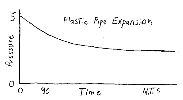

Even if some air remains, say that 99.9% of air was removed, per Boyle's Law I get a volume change of air of of 0.24 liters for a pressure drop from 5 bar to 4 bar. That is not much of a change. The system has a huge ratio of plastic pipe surface area to system volume. Plastic pipe expands (a little) under pressure.. and it would not take much expansion to account for the small volume change. I wager that the test is performed with the system at ambient pressure, then (fairly quickly) pressurized to 5 bar.
The plastic pipe then slowly expands under pressure, causing the pressure drop. Conduct the test as I described above (monitor pressure for a long time). If pipe expansion is the cause of the pressure drop (and there is no leakage), results should look something like this:

That equation is only valid for steel pipes.
PE pipes creep under pressure so testing is undertaken on a decay curve just like SRE has drawn.
Search for pressure test PE pipes if indeed "plastic" is PE.
A longer test will eliminate the pressure change from the water cooling off after fill as well. (It could heat up, offsetting some pressure loss, but that's not likely that shallow. 1200 meters is a long exposed surface of plastic pipe.)
Be sure to purge the air. It is difficult to purge the air in the pipe because of the long length of the pipe.
Purging
Another thing about geothermal pipes is that the polyethylene may stretch under certain temperature conditions. This leads to misinterpretation of the pressure readings. If pressure testing over a short period of time, you may see the pressure drop and assume you have a leak in the pipe, when in actual fact, the pipe is stretching. For this reason, it’s important to conduct pressure testing over a longer time period. Be sure to pretension the loop with hydraulic pressure before taking final pressure measurements.

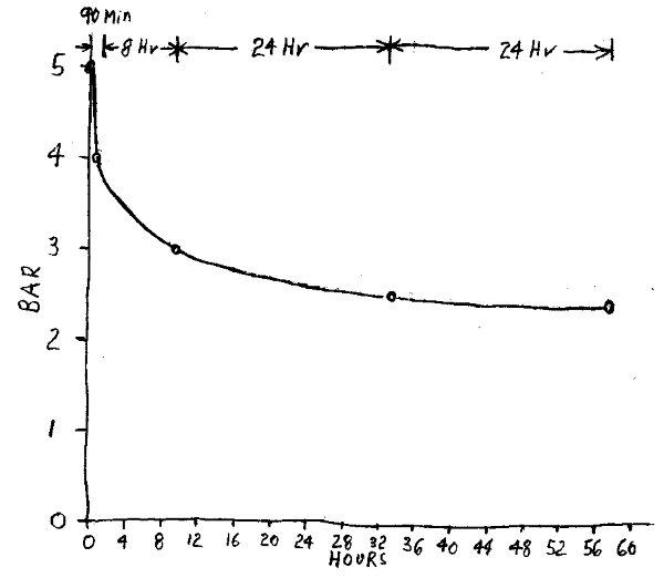

So after carrying out further tests it does look that the expansion from 5-4 bar is present but also coupled with a leak.
The water pressure does continue to drop but at a much slower rate.
this would be due to the lower pressure pushing the water out of the hole.
The pressure continues to drop from 4-3 bar in 8 hours and from 3-2.5 in 24 hours.
then only drops .1 bar the next 24 hours.
i think to offset 3 bar of pressure is quiet difficult on expansion of the pipe but could i be wrong?
i will continue to monitor over the next week and see what happens.
would it be more beneficial to leave the filling loop on continuously at 5 bar for a day or so. then carry out the test after as this would offset the expansion of the pipe right?
wes123 - You are looking at the "change in the numbers", and that is important. Sometimes it is better to look at the "rate of change in the numbers", this is much easier to do, by eye, with a scaled graph... often drawn by hand, with a pencil on graft paper... no computer or software required (although you could do it that way if you want to).
In 10 minutes time, I plotted your results (as I understand them).
Note: In this scanned image you will not see the lines on the graft paper, but they are there:
To me, this looks very much like the conceptual "no leakage concept" plot that I sketched a couple of days ago:
Does your test "prove" that the system is NOT leaking... NO.
Should you test for a longer time? The test is easy, I would. Edit: But at no higher than the design pressure, per comments by Little Inch.
But at some point, you will have to decide if test results indicate leakage or not... and what to do next.
