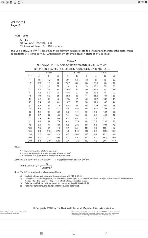

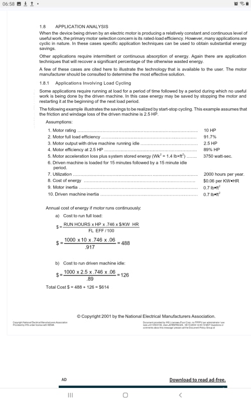

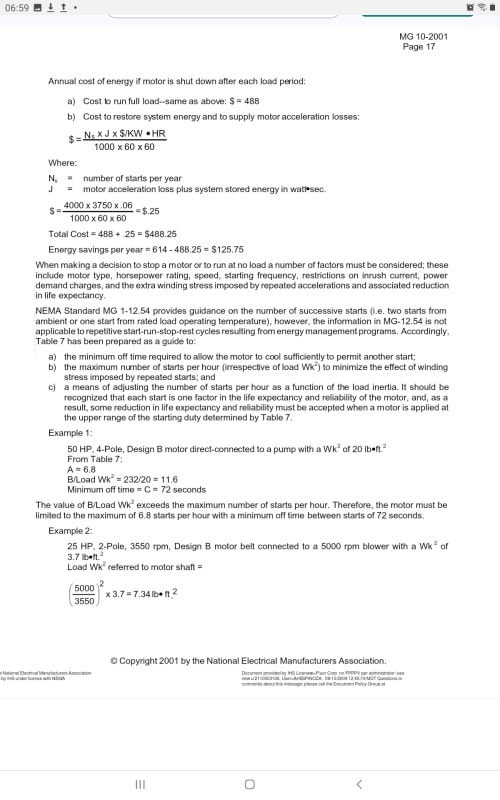

I have the option to not run the pump 24/7. Instead, I could run it for 4-8 hours per day. This would decrease total hours run by 75%, but introduce 365 start/stops per year. Which would you prioritize for pump longevity?
Change the question.
Will I save enough money by not running the pumps 24/7 to buy a new pump every year or 2.
If you save more money by stop start operation such that you can buy a new pump before the warranty runs out on the old one, well yes, you definitely want to do that.
Found some restart info in NEMA MG 10
