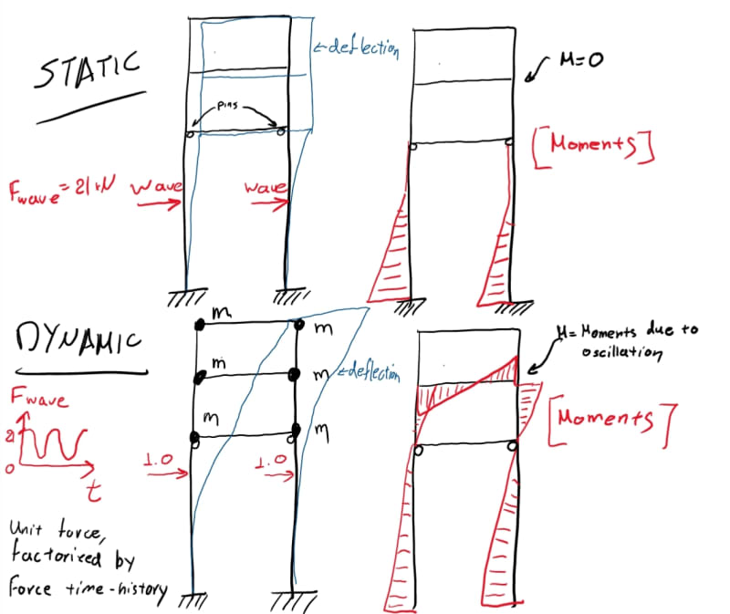

I design a 2-storey steel building on a jetty head which is 100m into the sea. The water depth to seabed is shallow and waves are small (Mean SWL 4m+3m storm surge, Significant wave 2.5m). The jetty is a set of unbraced steel hollow sections (Diameter 457x16) @5m centres.
I want some opinions on whether I need to design the steel building elements & connections (steel frames) for wave actions. So far I assumed the substructure and superstructure are separate, and performed static analyses for each individually.
I followed BS 6349 which uses the Morrison equation to determine the wave actions. This generates a maximum force 21 kN. It also gives me the wave profile with time.
Should I perform a Time-history analysis? My experience from earthquake design tells me that a spring mass system subject to cyclic velocities/accelerations will generate forces on the first storey due to the motion. However these forces are invisible in static analysis. So should I do time history and design beam/column connections for the wave? Is this common practice on offshore structures?

I mean the wave force is applied on the piles. The deck level is above the wave load.
On a static analysis (single pile) this is a cantilever with a load applied around mid-height. Moments above deck are 0.
On a dynamic analysis, the wave induced displacements generate inertia forces on the masses due to the push-pull effect of the waves.
I have attached an image for clarity:
Unfortunately your diagram raised more questions.
Static load deflection of above deck structure is not correct, unless the pins are actually in the columns. You have made the pins to look like they are at the ends of the beams, hence the columns would be continuous at floor levels, more like as you have shown in your dynamic load diagram.
In your dynamic diagram the beams are experiencing reverse bending. You have only drawn the top beam and you have shown it as a flat translation, which can only be if beam has pinned ends, although you seem to have shown moment resisting connections to the columns.
Could you please be more clear about how beams and columns are connected and why you think they change between static and dynamic cases.
Thank you for the response, this is a quick sketch. The Deck beams are pinned. The rest of the beams are fixed against lateral loads (Type II/ Wind frame). The bottom "columns" are the piles. So they are not continuous. On top of them we have pinned columns of the building (steel frame).
I don't understand what this has to do with the time history analysis though. The question is whether you consider the dynamic case or not, regardless of the structural system formulation. Have you worked on a similar structure design or platform where this had to be taken into account?

This is a Wind Moment Frame building (ref: Link), so the connections are designed only for the wind load moments (not gravity loads, everything is pinned for vertical loads, but fixed for lateral loads). So my question is should connections/members be designed for wind+wave loads.
Yes, they absolutely should be designed for both moments. Here in the states we refer to those as "partially restrained moment connections." It's neat in theory, but a pain in practice - though we have alternative procedures to simplify it. Since your frame is going to try to rack with the wave action, the rigidity that does exist in that connection will "attract" some proportion of the moment in the frame. If that moment is too great and your moment connection fails, you'll be in trouble next time the wind blows.
