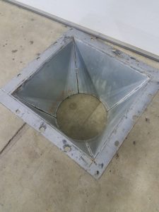

Hi, a friend of mine who works in a workshop has told me about a strange fact happened during a pneumatic test of a stainless steel "transition piece".
This transition piece is a short section of pipe (lenght about 1m) with 2 flanges ad the end, but at small end both section and flange are circular (O.D about 200mm) and at large end both flange and section are rectangular (about 500x700mm), something like this one below:
Flanges at both sided were connected to other flanges with classic bolts+nuts.
What is really weird was that happened during the phase of pressurization of this piping: when pneumatic pressure overcome 0,5 bar, this piece started to "bang", making sounds of blows or something like that, with a slight deformation of the external wall. At 0,7 bar he decided not to continue and vent out the vessel. Please notice that vessel wall (3mm thickness) returns in a as welded original state, without permanent deformation.
Do you think it's normal? What causes these sounds? There were no air leaks but they were all scared of these banging sounds...
Thank you
That's a complex shape going from circular to square and especially being welded has a whole load of stresses and inbuilt strains that when pressurised are slowly being reversed until the part flexes into a different shape.
The stress concentration in those welds is large and I've no idea how you actually design rate such a strange shape. FEA is the only thing I can thing of.
Normal? No, but this is not a normal shaped element.
Just put it in a safe location and pressure it to what ever you think is a good number and see if it breaks?

Those flatter sections will 'oil can' easily.

Thinking about it, considering the small thickness and the change of external shape (from a circular curve to a plane) I suppose that weird sounds are "normal" because material is stretching due to internal pressure but my friend can't quantify how dangerous the situation is since he can't understand if material continues to work in elastic range...
When you put a dent into a tin can or soft drink bottle and then pressurise, it will make banks as it buckles back into its original shape. This is not a safety issue.

Looks like a square to round transition piece of ducting used for dust extraction/LEV - looking at the website address of the photo '...grainsupply..." I may be right - for a grain silo? In which case the working pressure is generally below atmospheric.

Photo I posted has nothing to do with this real case, I've chosen from web only for example to let me show the shape...
Transition piece of my friend is part of an air heater system, this is what he told me
But it's still a circular to square duct transition piece no?
All my comments still apply if this complex shape is being tested.
