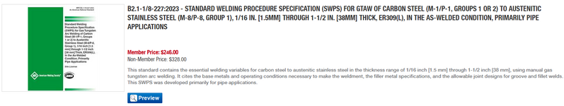

Agreed with SW. Depends on what steels you're talking about. No document provides the list you're searching for, at least as far as I am aware. However, you can sometimes weld dissimilar materials, with a common one being certain types of stainless to mild steel (see AWS publication below). If you can try to find an AWS publication covering your situation that's at least one way to go.
You also may find this publication useful.
