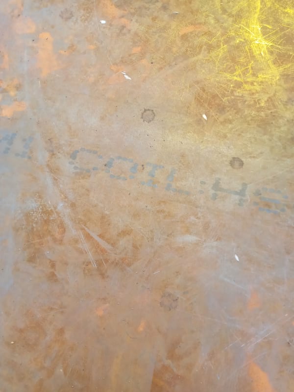

It's also possible that the root cause of your issue could be that your bottom plate was cut off of coiled material without a temper pass to remove the built in stresses from de-coiling. If so, the act of welding makes it sproing.
I found the boilermakers handbook. Very useful information inside. Adding it to my collection. The material is definitely much bigger than standard plate. Could be from coil. I'll look into it.

Floor under tank floor is tar. Under tar is concrete. Can confirm plate is def from coil.

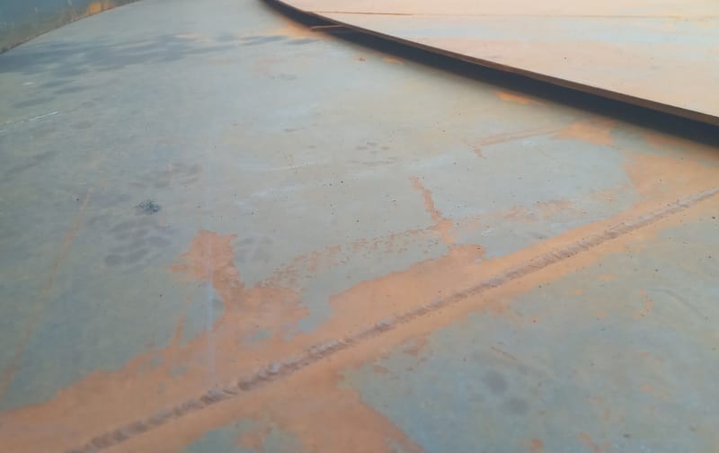

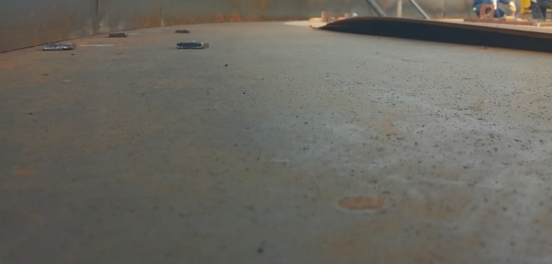

Photos of warpage:
Its always a challenge to take photos and still make sure site cant be identified.

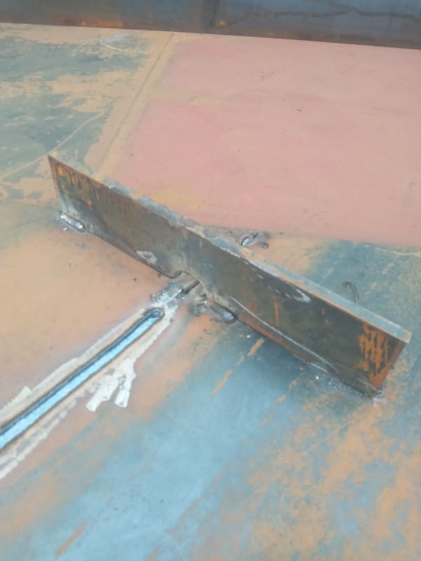

To be honest I think these warpages were caused by our strongbacks not being up to the task. We made them out of 10mm plate and they also warped with the plate. The 16mm ones we made later were much stronger and seemed to have prevented warpage further on.
Best suggestion ive had so far is welding dogs to the annular plate after the first layer of the shell is finished and wacking the warpage down with the combined effort of a heating torch, wedges and a 12 pound hammer.
When I talk about strongbacks, this is what I mean.

Not important but the weld in the strongback picture looks like a sub-arc weld.
