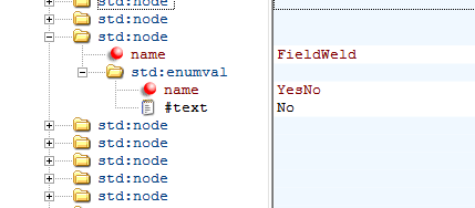

I dug into my sheet standard .xml. There is a section for the field weld symbol, however, it only allows you to default it on or off when you initiate the weld command.
Is it possible to add attributes in the XML to control its text height? If that's possible, it might give you what you want. Another thought is that maybe theres another file to control the weld command similar to view names in drafting.
I tried altering values for text height, type, scale and it reacts on a global scale for the entire weld note/symbol system.
XML attributes are just text unless the program reading the XML has a function to make use of them.
