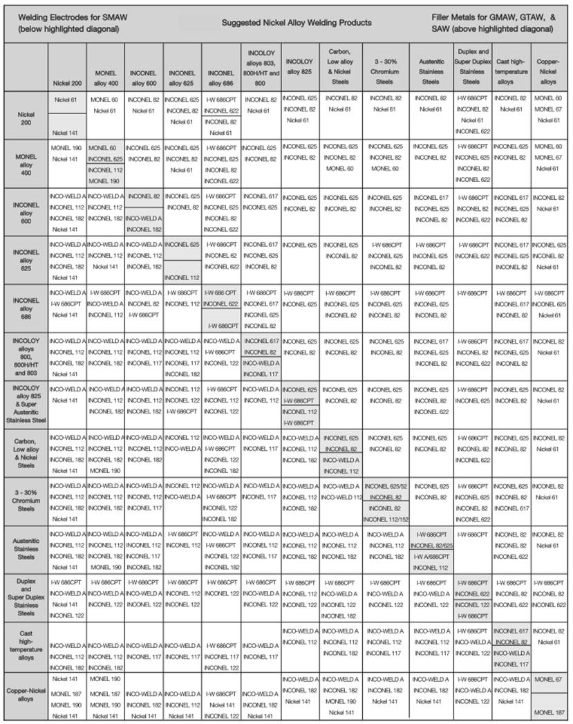

Does anyone has experience to weld alloy fittings to 316L piping. It is a temporary solution to achive mech completion and start-up as alloy piping has a long delivery time. We also will have problems to get DN400 fittings in 316L here in Korea. The alloy fittings are in our stock.
We will operate only at max. 550°C instead of normal 700°C.
Can it bewelded?
What filler has to be used?
Any heat PWHT necessary?
Our plant is in Korea and welders for alloy625 are difficult to find. So it will be a challenge to finish this job within 4 weeks.
Yes. The matching 625 filler metal can be used as well as oher Ni based filler metals.
When I was a rocket engineer, my welder would use Hastelloy W rod as filler for a mixed joint like that.
The filler suggestions are all valid.
No PWHT required as these are both austenitic alloys.
Getting a procedure and qualifying it and the welders will take some work.

How about this:
The 686 would give higher corrosion resistance, but you don't need it.
The 82 is more versatile and can be used for a lot of dissimilar metal welds.
Using 625 filler is the most straightforward option.
The biggest issue will be the higher melting point of the 625.
There are other alloys that would work, but stick with things that have been used.
You have looked into the difference in thermal expansion between these two alloys haven't you?
