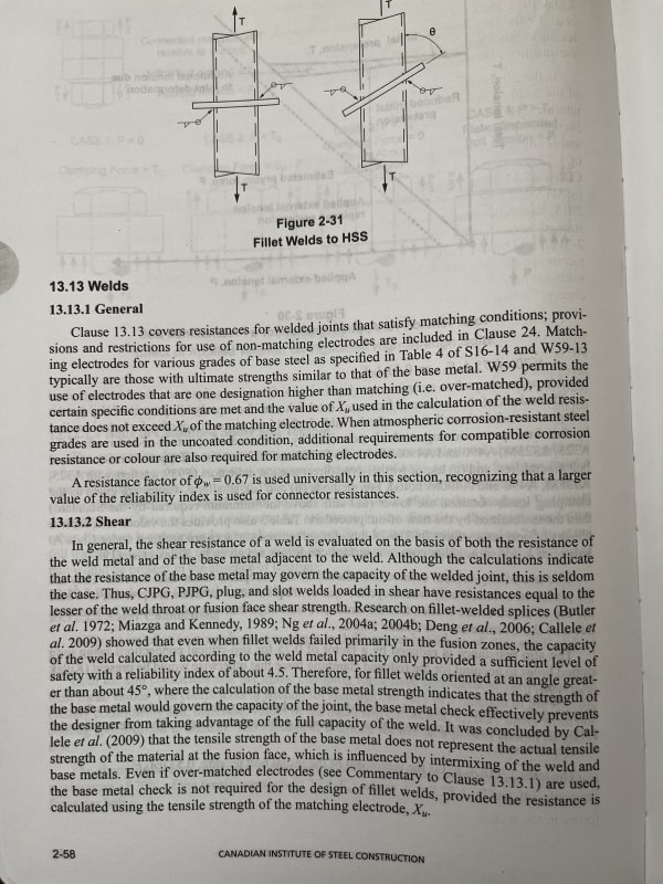

I'm assuming your typical notes call for E70xx electrodes and I wouldn't change that. From a design perspective, you'll be more likely to have the base metal govern the weld design. I see you're using CSA S16-14, the 2019 code is the most recent. Check the weld tables in Part 3 (table 3-25) and compare the values in the 2014 version to the 2019 version if you can. In the 2014 edition, the weld capacities level off at about 45deg where is in the 2019 edition the values continue to increase all the way up to 90deg. That is because the base metal check was removed in 2019. There was some debate in my office if that was appropriate or not. In your case, with the lower base metal value, you really should be checking the base metal capacity.

EngDM - you the reference you need to check the weld; S16-14. As noted above, S16-19 is the most recent and there was a change in how the base metal check is handled. I suggest reading through S16-14 and S16-19, both code and commentary, to get a better understanding of this concept. See excerpt from the 2019 commentary which discusses the base metal check.
