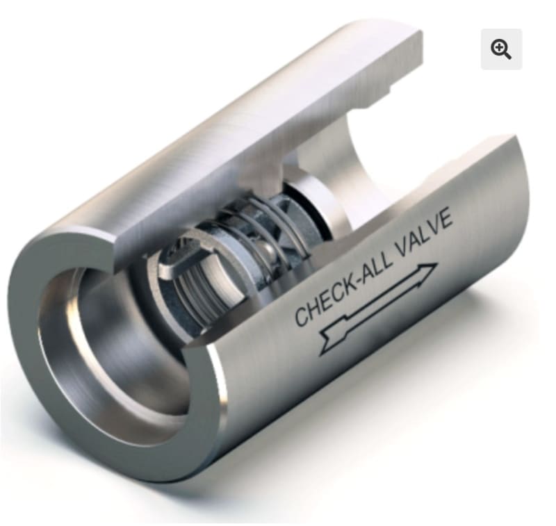

Dear All,
what is the common practice to socket weld valves with internal gaskets e.g noeprene, N-Butan. The heat impact can damage the gaskets. The supplier does not provide a clear instruction other than "use heat sink or other method to avoid damage".
There are many ways to do it but what are your preferred and daily method to get it done. Attached 2 samples; control valve with installed PTFE gaskets in the body and check valve with neoprene gasket.
 https://files.engineering.com/getfile.aspx?folder=5f19331d-567a-4743-85ef-17156fc572ee&file=CheckValve.jpg
The most common way I seen is using metal seated valves and avoiding vulnerable soft goods entirely. Or using flanged valves.
Your control valve example didn't upload, but that check valve is available with metal-to-metal seat option.

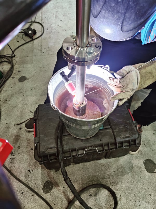

Some more information. Sizes are 1-1.5" in 316. We finally used a bucket of water since the short pipe spool fit in.
Stefan
If this satisfies , and it works. Just be advised. That moisture is not conducive to welding.
It causes porosity. that is why argon was used as a back fil.
But if this a low pressure, and the welds are no concern to pass NDT. Then its good.
