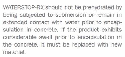

But even if a keyway is used, bentonite waterstop should not be in the keyway:
Concern about getting benonite waterstop wet prematurely is valid:
See: Tech data for this brand of bentonite waterstop.

Thanks to both of you for your comments. I agree that if I use a keyway I should move the waterstop up out of the keyway. I would need to check the required clearances though. Better yet to just omit the keyway and roughen to 1/4" as suggested. What is your experience regarding the ACI requirement for wetting? Do wall to footing construction joints typically get wetted in the field?

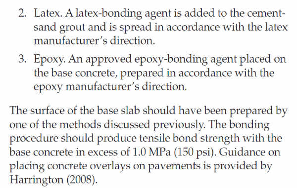

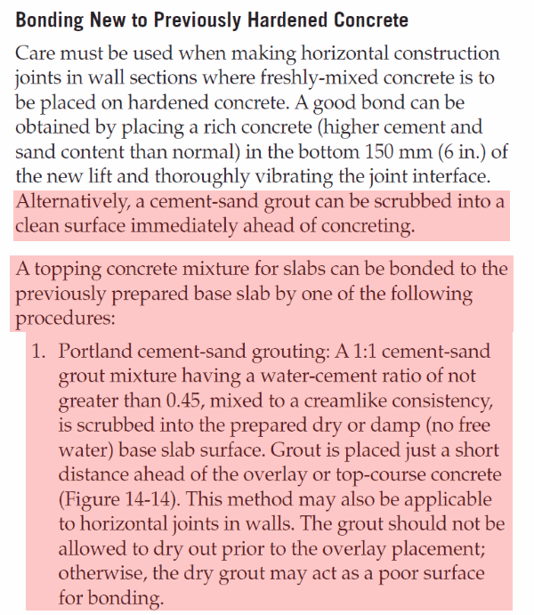

The method oldestguy suggested is addressed in Portland Cement Association (PCA) "Design and Control of Concrete Mixtures", Fifteenth Edition (2011), Pages 281 and 282:
Don't take my word for this, buy the current (Sixteenth Edition) from PCA,
or Google on "Design and Control of Concrete Mixtures"... amazing what several of the .pdf links contain.
[idea]
Thanks, SRE. According to the PCA, the surface can be "dry or damp" as long as there is "no free water", and slurry can be "scrubbed" in to the surface (which sounds like a lot of work) or a bonding agent may be used.
Given the labor-intensive nature of applying the slurry to the surfaces of our deck repairs and overlays, I doubt that ever happens in practice. The high-slump consistency of the SFMC, probably makes it unnecessary anyway, though. I'm pretty sure they always make sure the concrete is damp, but without any free water, before they pour.

Dry or damp, I doubt it makes much difference. The part I cringe about is the suggestion of an epoxy bonding agent, which for the reasons Agent666 described, can instead be an effective debonder.
Yeah hokie66, we're pretty wordy with our directives for the use of the epoxy bonding compound. The gist of it is, if it gels before they're ready to pour the concrete, they have to sandblast it off and try again. We also don't rely on it for shear strength, more to provide a watertight seal than anything else. Anything that requires substantial shear capacity gets a keyway or at least an intentionally roughened surface (1/4" minimum relief).
Wordy doesn't get results. I hope you are there watching it. Instead of specifying those bonding agents, I prohibit them.
We have field engineers and inspectors who are supposed to be watching it all carefully. As I said, we don't rely on the strength of the bond at the joints where we use the bonding compound, anyway. There's always reinforcing crossing the joint, and where shear capacity is required we make them form in or cut in a keyway.
