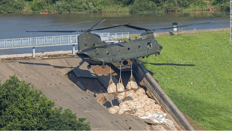

More decent information here:
Basically it's 180 years old, built mainly of earth and possibly some clay. Built to feed the peak forest canal which is still in operation as a leisure canal and apparently now also a wildlife refuge.
They are basically draining it as fast as they can via the normal feed into the canal.

I take it water was spewing from the hole pictured above and they've amazingly gotten the level down below the hole now?
As far as I can tell no. If water starts spewing from a dam hole then it is usually all over, especially if it is an earthen damn.
This isn't too different Oroville damn spillway failure.
To summerise:
Water was flowing down the spillway as designed but due to poor design/maintenance the concrete spillway failed enabling significant erosion on the back side of the dam. If such a scenario continues damn collapse is almost inevitable.
(I typed all the above quickly. So if anybody spots any mistakes I've made then please forgive me and correct me.)

That's what I was thinking but if that was a spillway that explains the possibility of avoiding a catastrophe.

The Army are currently sand bagging the dam and pumping out water to lower the head of water. Seems like all they can do for now in the short term. I image and remediation work cant happen until the dam is lowered below the level of the failure.
