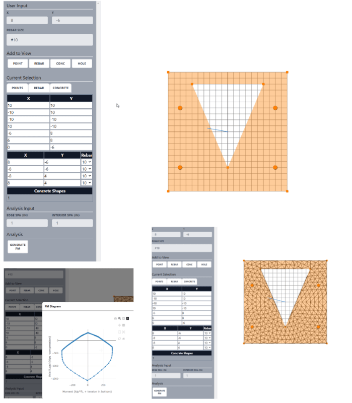

Has to be the 2,000 lines of javascript/htlm code to make an arbitrary concrete shape analysis tool.
I have yet to use it in actual analysis, but it was fun to make.

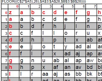

My wife created a spreadsheet for me that multiplies alphabet letters as a base-26 number system (z=0, a=1, b=2, etc.) I used to have aspirations to think in base-26, but got bored with it and moved on to other wastes of time...
