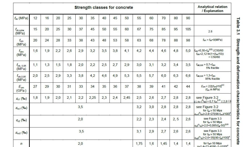

In the Eurocode 2, to calculate minimum reinforcement, there's the following equations.
For the concrete grades above C50, the last formula is used. However, it contains "Ln", does it mean effective length of the beam, slab etc? Or something else? I didn't notice the definition is given.
(Table 3.1, Eurocode2, page 29)
