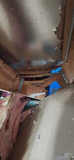

I’ve seen cross-grain bending failures irl. I’ll dig up pics today. It definitely matters; it’s just that the NA thing is only a rule of thumb. It can definitely still happen thereover.

Behold. Unique set of circumstances, so don't take away from this that the hangers were the cause. They weren't. Can't go into more detail than that.
Looks like someone notched the crap out of the beam
