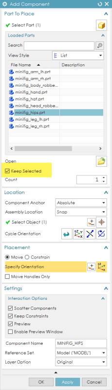

We just went to v12 and I have to keep starting up the add component dialog to add screws. And I got a buttload to add. No ref patterns to use BTW.
Function is gone.
If you tick on 'Keep Selected' (see image below), once you place a component, use middle mouse button to apply & then it you can place the next one & so on.
