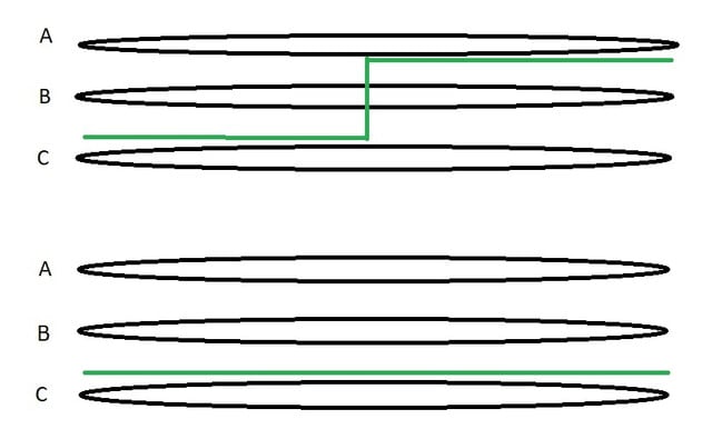

I'm working on a project where the customer is pulling 1/C #750 through conduit in flat formation, underground in a duct bank via single point bonding. So each phase is in a separate conduit.
IEEE 575 says to transpose the ground conductor at the midway point if using single point bonding. However, the project says they might not transpose the ground conductor at all.
Does this affect induced voltage?

^^Did you respond understanding that we are talking about transposing the ground conductor here? I wasn't talking about transposing the phase conductors.
I don't believe transposing the ground conductor cancels out induced voltage, as I have calculated the induced voltages for these cables and they are not zero.
IEEE 575 does show what happens for multi conductor cable if the ground conductor isn't transposed, and what happens is that the induced voltage doubles. However, they provide no calculation backup for that, and I'm not quite sure the same applies to single conductor cable.

The concern is what happens to the induced voltage on the phase conductors though, due to presence of the grounding conductor. I understand your comment regarding the phase angles cancelling out on the ground conductor - but how does this affect the phase conductor induced voltages, with respect to transposition vs no transposition?
Are you saying that without transposition of the ground conductor, the phase angles will not cancel on the ground conductor, thus creating a higher circulating ground current, which leads to higher voltage induced on the phase conductors by the ground conductor?

Yes, the conduits are non magnetic. The cables are single conductor #750 so I'm assuming because of the size and also due to pulling tension they are pulling the cables in single conduits. I get what you are saying in relation to transposition; however I can't make sense of what actually happens from an induced voltage perspective. Simply, the following picture is what I'm trying to figure out.
The equipment continuity conductor (ECC) is in green. Top is transposition (midpoint), bottom is not.
For a single line to ground fault, assume the induced voltage across any phase is 20 volts/meter.
If you analyze the untransposed diagram , does that 20 volts/meter increase, and if so, by how much?
IEEE 575 has an example on this where the induced voltage doubles without transposition, but that is for multi conductor cable. It says nothing about single conductor.
