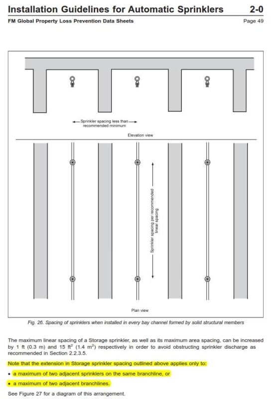

What I have is an FM global warehouse with peak @ 32'-4" and weird bracing at end bay
SprinklerDesigner2
Nov 30, 2006
1,251
I have a 60,000 sq ft warehouse that has an existing system that FM Global wants "reinforced" which can be interpreted as replaced.
See the layout below and it does appear to me we could meet FM's requirements on minimum spacing by installing a baffle on top of a W8 beam as shown in my sketch below:
One of the options given by the FM Field Agent was K16.8 upright sprinklers discharging 10 sprinklers @ 35 psi.
Luckily we have to deal with the beams, which have to be for wind bracing, on just the end of the building. I included a couple photo's to try to make things clear.
Look at figure 26 which appears to fit my layout. Anyone have experience with this?
Are you trying to use baffles to be less than 8' on center? If so, that is not permitted in straight NFPA 13. You may be able to get it through on FM stuff as you have the highlighted text to support your position.

From FM's recommendation letter:

I am not really sure how to interpret this.. seems to me I am limited to two branch lines in the space but they need to be at least 8'-0" apart.
I will call the FM rep for this project but I am hoping to get a "jump start" if you will.
Factory mutual has eliminated use of the term ESFR or CMSA for sprinklers. They are storage or non-storage sprinklers. As I understand it, you basically have to treat all storage sprinkler spacing like we are thinking ESFR in NFPA terms.
It does seem that FM does have the guidance for being in every beam pocket, so you should be good there. I would definitely want the FM rep to have a say as well.

It does appear I'm good but I fired off a detailed letter to the FM field agent this morning just to make sure.
