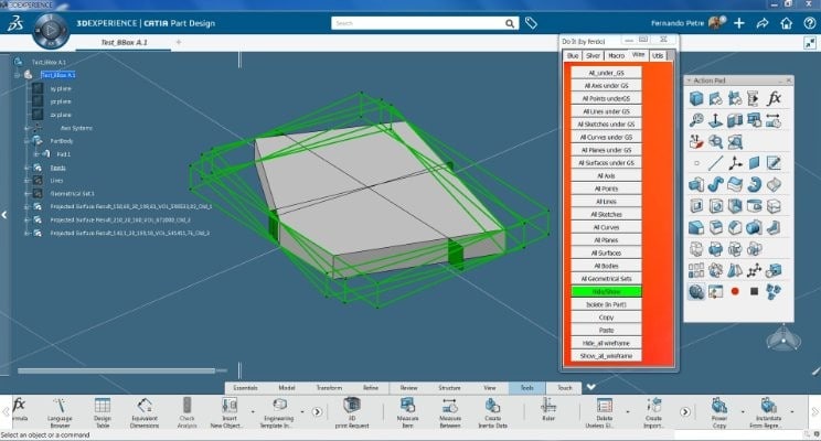

I find the best way to create separate application (.exe) using vb.net in visual studio (or alternative). Easy to deploy with no user settings :) To protect the code, I just read the Windows user and give access only to desired users.
How many users do you have then? And how many software developers? ;)
I have maximum 30 users and for the moment only one software developer ... me.
No issue to distribute the tool, only the issues inside the code :)

I have created a form for macro startup. (CATVBA)
Simply fill out the tag in the header part of the module file and add it to the VBA project,
the macro start button will be added.
I upload source code here.
Link
Processing of out process macros is slow and can only be used for the first CATIA that started, so most of the macros I make are CATVBA.

I saw several months ago your blog and is really very interesting and full of samples, it would be great to answer here on the forum more often, Google translator is good enough for Japanese, believe me, I understood a lot from your blog.
Your catvba is somehow similar with what I've done for V6R2013x few years ago and for 3DEXPERIENCE several months ago (I saw you are interested in this subject, here are all my articles about this.
And also you can find on my YouTube channel several videos.
