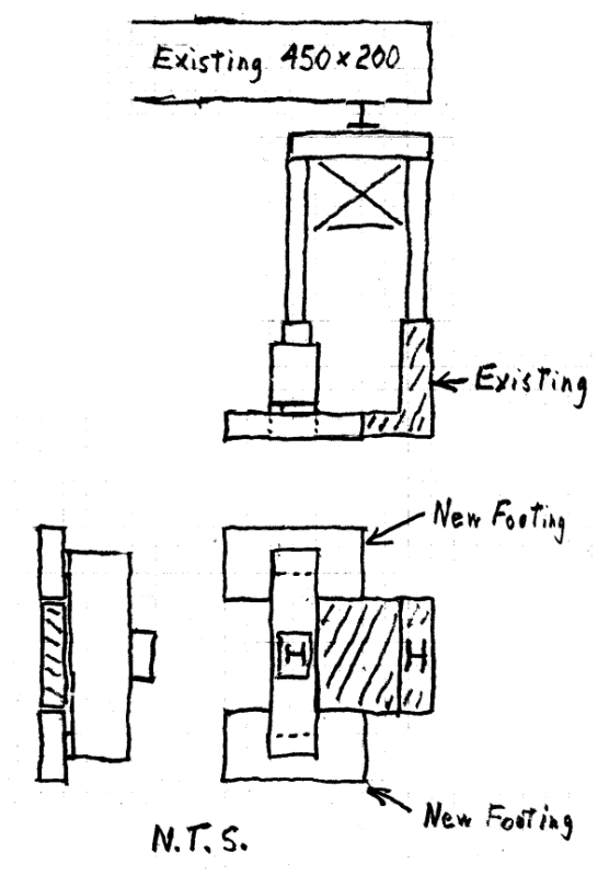

Here is my proposal:
A pair of new footings , one on each side the existing footing.
A concrete beam, with pier for a new column on the beam. The beam distributes load to the two new footings.
A single structural steel support for the existing 450x200 beam.
Features:
1) Existing footing remains unchanged, no new loads applied to the existing footing.
2) No connection between existing and new footings, (reasonable) differential settlement not a problem for footings.
3) Single support for existing beam allows predictable load sharing between existing and new footings. (Reasonable) differential settlement not a problem for structural steel.
[idea]

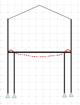

DJ -- unfortunately, a straightforward analysis is not likely to represent this problem well. You need to account for three factors in some way:
[ul]
[li]staged/sequential loading[/li]
[li]settlement of the foundations (which governs vertical stiffness)[/li]
[li]how the new column is fit to the existing beam (affecting vertical stiffness)[/li]
[/ul]
I quite like SRE's solution.
just call me Lo.
The beauty of SRE's solution is that it solves the problem of how the load is shared between existing and new columns by simply adjusting the reaction points, but it means the existing steel beam must be adequate to span between reactions as a simple span with very short cantilevers on each end.

@SRE...nice solution.

Make your footing as shown, and provide the frame as suggested by SRE.
