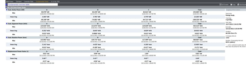

And this is the fundamental. They are slightly different.
I suggest reading the manual, but I'm guessing the RMS values are true RMS values that include all harmonic content the meter is capable of reading in the calculations, and the fundamental values are the values at the fundamental frequency of the system only.
