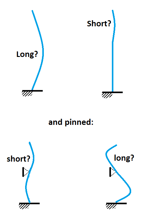

So short wavelength buckling would correspond to two waves between the pinned points, and long wavelength correspond to one wave between the pinned points?
Like this?
Upper right could be a short wave, though typically is even short compared to structures length. Lower left is still a long wave. Why is this an issue?
long wave buckling is like euler buckling, buckling of the gross section (possibly with multiple nodes, as shown above).
short wave buckling is crippling.
