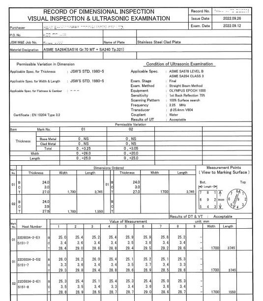

The vendor design is that 11+3 (min)after explosion bounding and 12+4 (nom)before explosion bounding.
I think that 1 mm of thickness reduction for both clad plate and base plate is very high.
1. The base plate. I think there is no need to consider the thickness reduction from the nominal thickness for the base plate of SA516Gr70 if it is still within the plate nominal thickness within the tolerance between -0.3 mm and +0.8 mm after the explosion bounding as per SA-20:"Plate material with an actual thickness less than the design thickness shall not be used unless the difference in thicknesses is less than the smaller of 0.01 in. (0.3 mm) or 6% of the design thickness".
2. What is the permissible thickness variation for the explosion bounding to be considered in design in general? This is the important data to check whether the actual thickness sufficient after explosion bounding.
It is 0.3 mm to 0.325 mm dependent on the plate thicknesses from the reference of Dimension Inspection Report.
